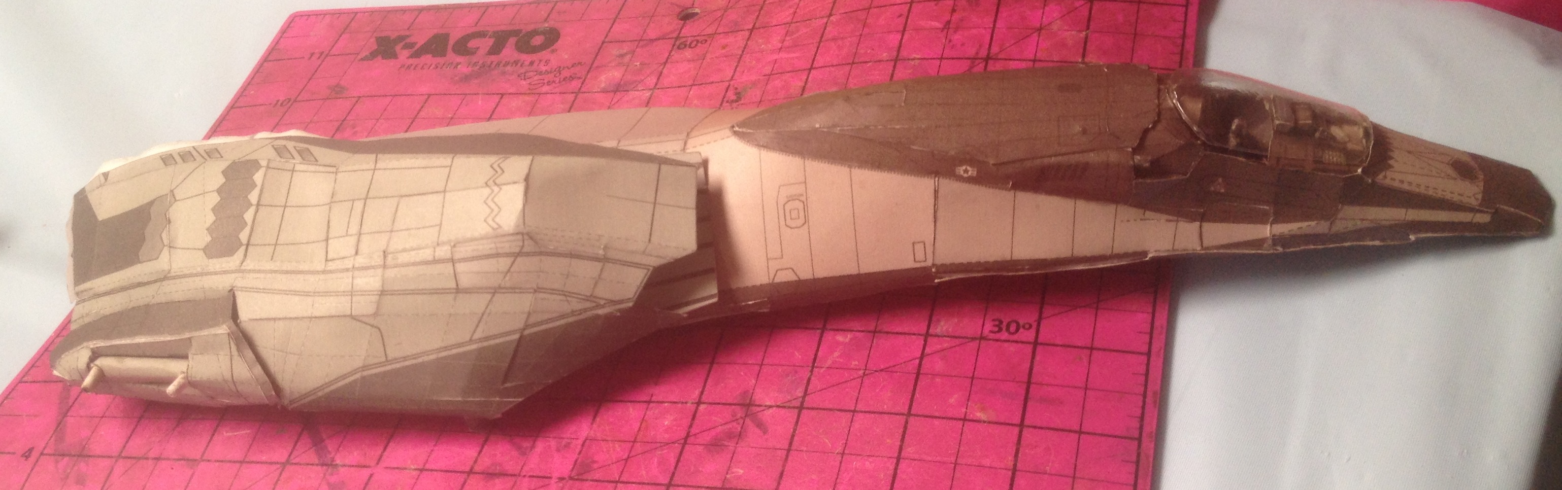

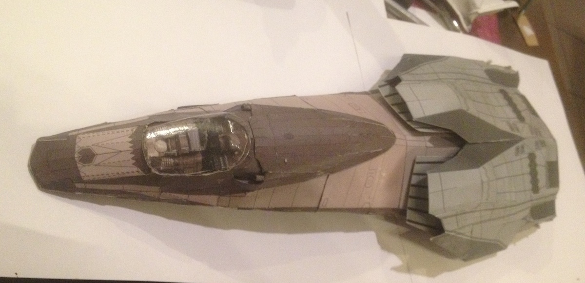

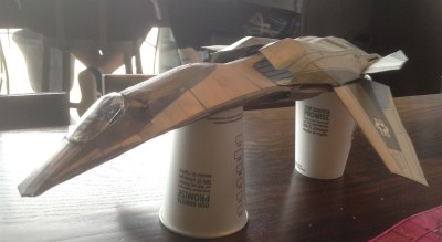

FA-37 Talon WIP....been working on this paper model design for over 13 years....Most complex and difficult design I've ever done. Not only is the fitting very precise, but the parts have to be bent to the right angle to fit correctly. This pic was the 6th rebuild since November and the 4th since January.
This was originally a contract project, but the client suddenly backed out in the middle of the project. I've been working on it as i've had the spare time.

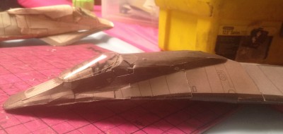

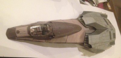

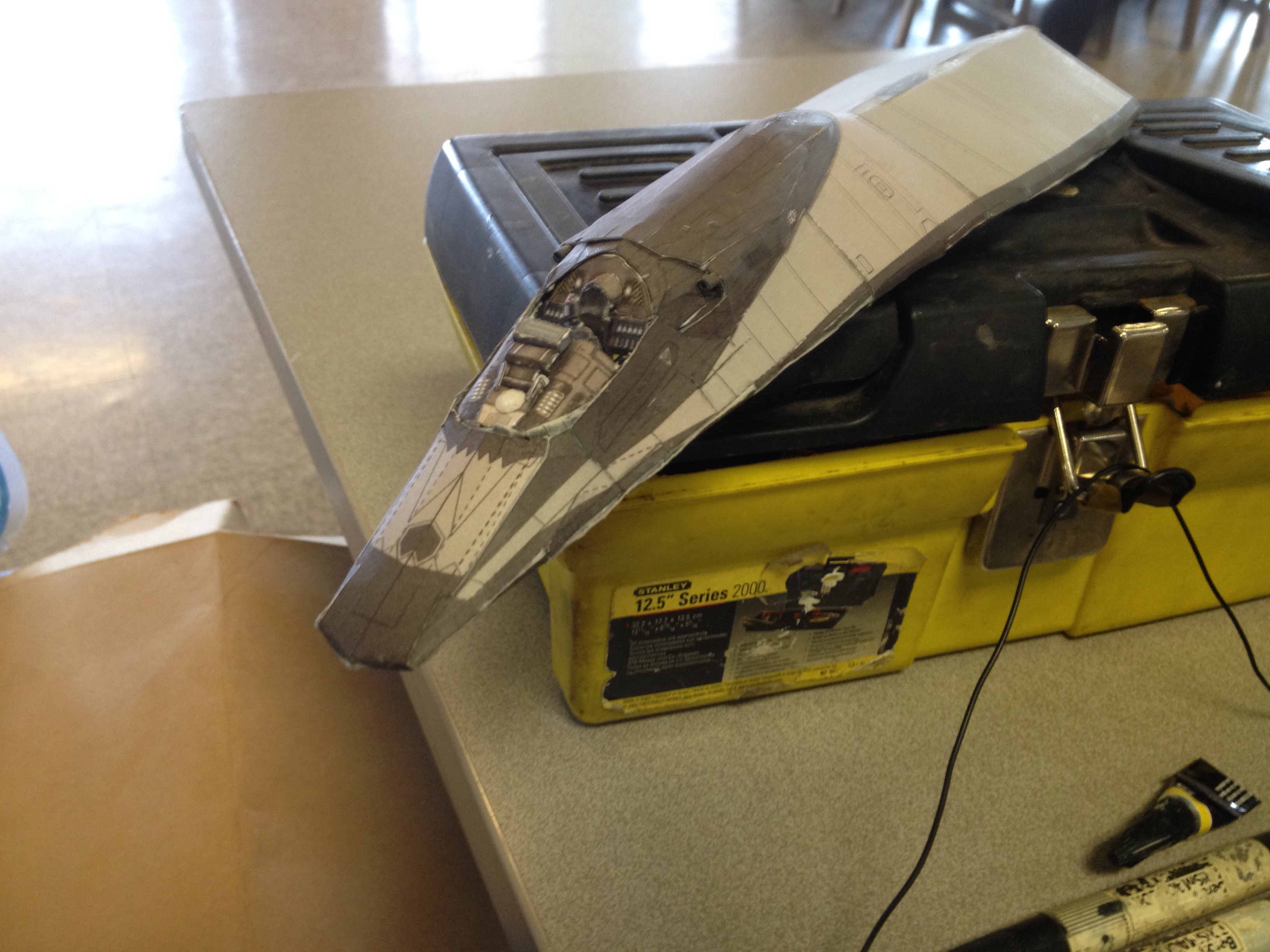

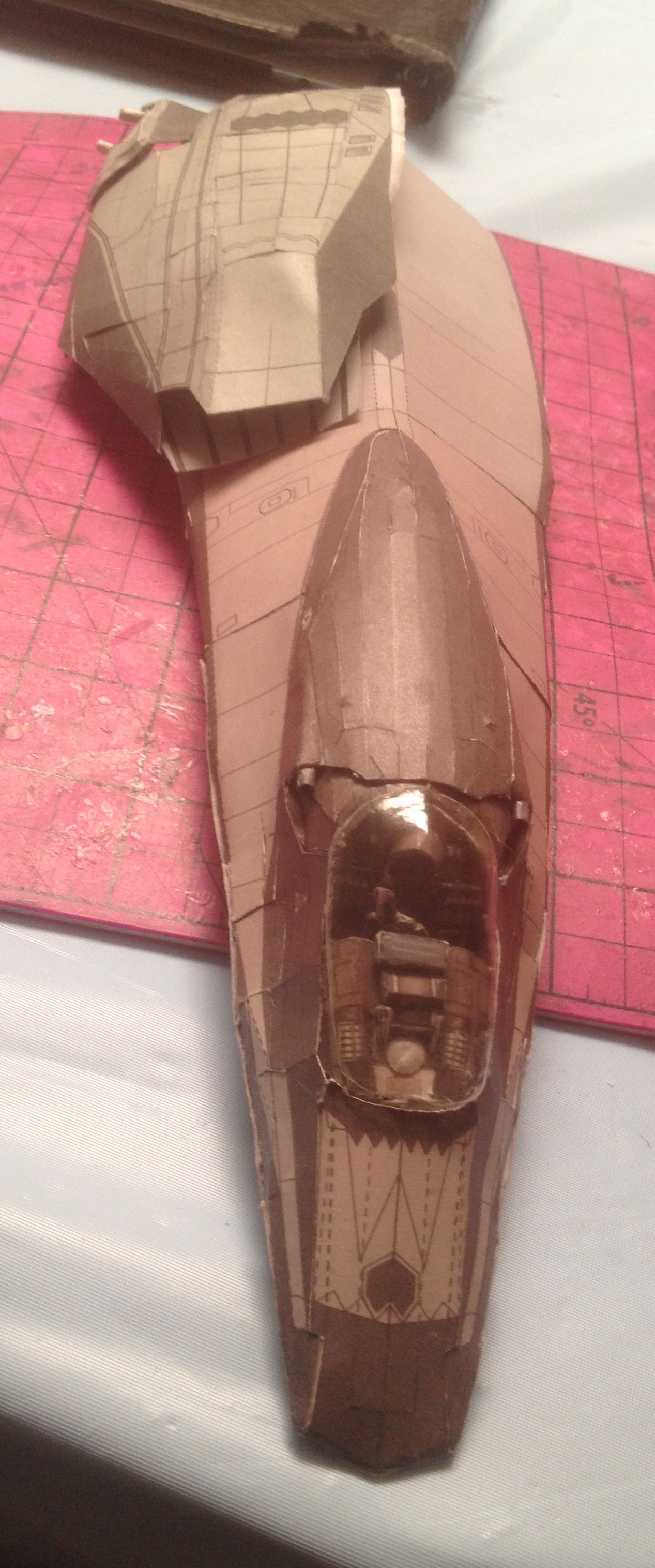

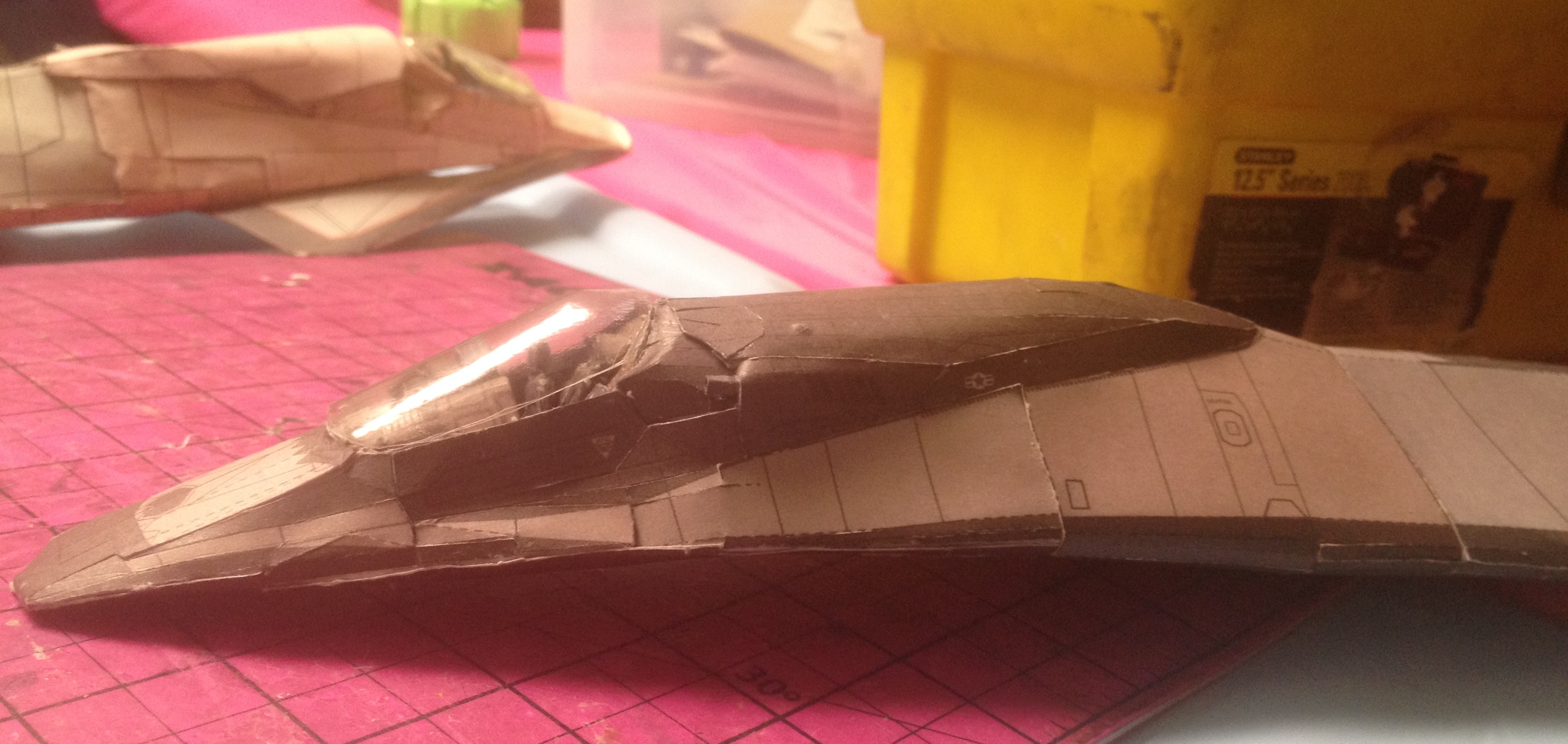

More updates...cockpit and buck from scrap packaging.
The buck was made by gluing the cockpit glass pattern with the tabs out, painting a layer of white glue on the inside and once dry, filling it with Aves Apoxiesculpt (or you could use Sculpey or Fimo). Once the material had set, I soaked it in water to remove the paper and sanded it smooth.
Normally, I would have mounted the buck to a tall piece of plastic (like a Mentos tube)and then heated the piece over a candle and pull it over the buck. However, I had purchased a 1963 Mattel Vac-U-Former and wanted to try it out. When I cut the glass out, I left a tab in the front and back to help it stay in place (I will glue it down when the model is finished).
Also pictured it the port upper intake; placed but not glued down.

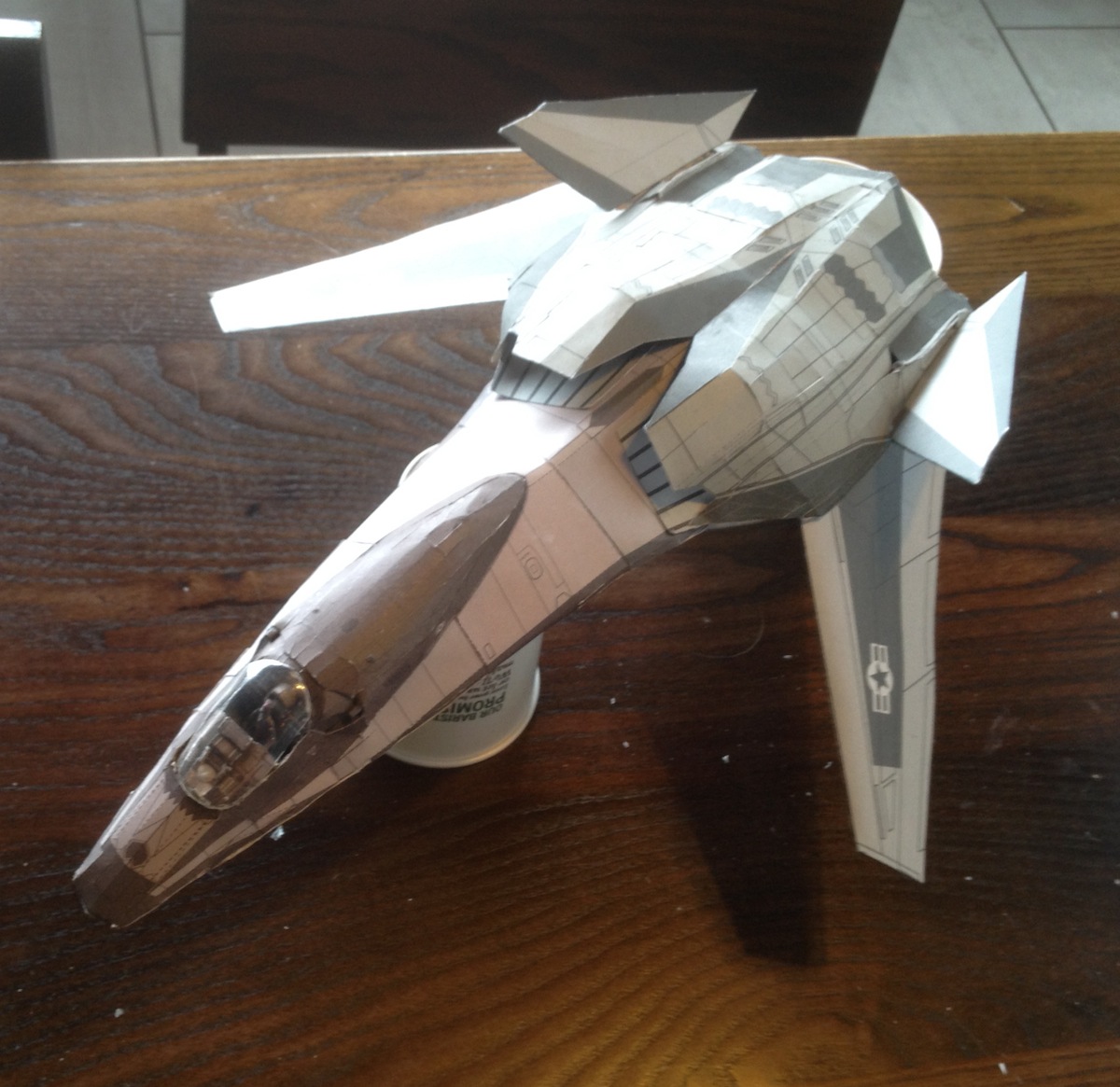

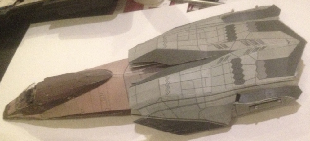

Upper intake assemblies done...

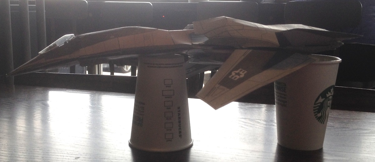

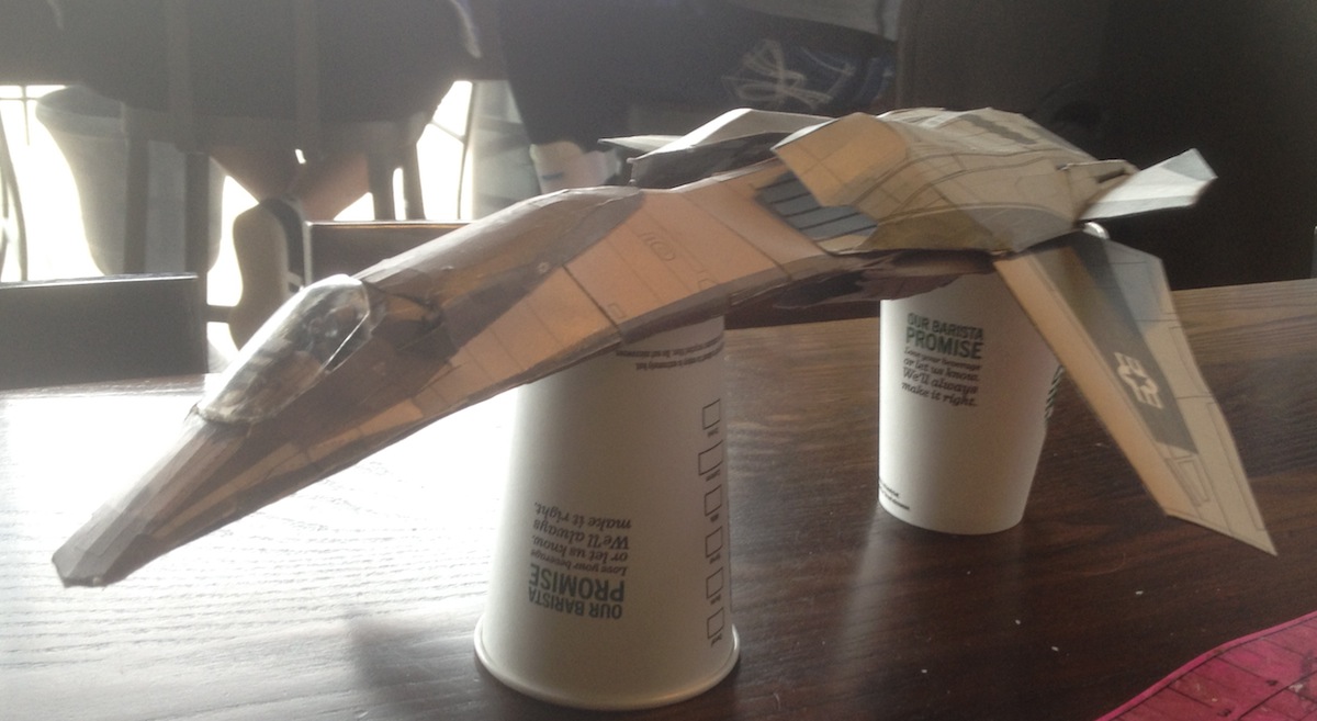

Seeing the end of a 15 year design project in sight....98% completed....just some directional thrusters and landing gear, then 80-120 hours of instruction manual art to do…

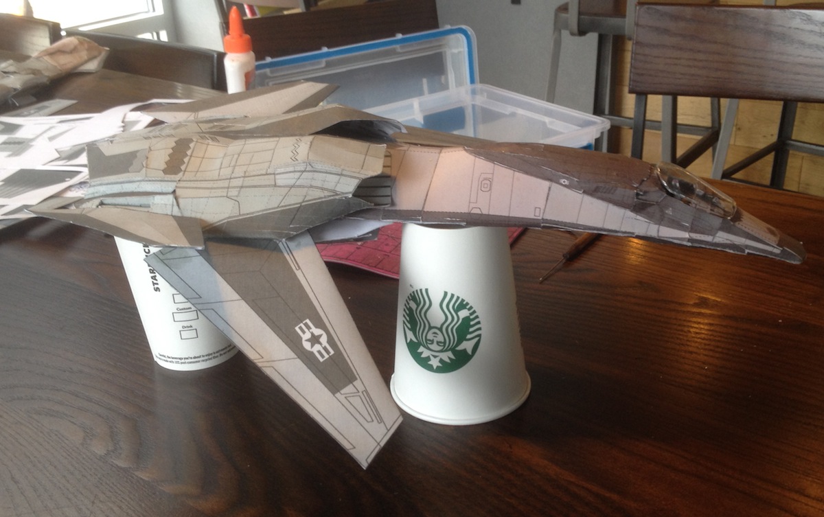

This model was a contract model. The contractor backed out at the alpha build stage and I never recieved payment. When it is finished I will be selling it to recoup my costs (and make my wife happy).Edy a écrit : sam. sept. 15, 2018 11:34 am Très joli modèle!

I should note that this is not an easy build. I have rebuilt the fuselage six times to get it right. It is the most complex design I have done and the most complex design for an aircraft I have seen. not only do parts have to be joined properly, but also at the right angle to get the right shape and "seamless" construction. Definately not for a beginner paper model builder.

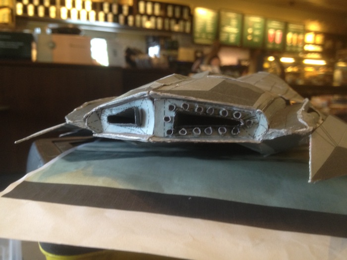

OK, aside from an insane work schedule, I have to admit to having a 6 year old "I don't wanna!" moment of not wanting to cut and roll 28 2mm x 2mm cylinders for the directional thrusters (something that was NOT on the original production blueprints, but added later). Anyway 2 hrs of staring through magnifiers later (part of the time was raging at the landing gear wheels for being too wide upon completion)...I have 14 on....

Ne t'embête pas à faire vingt huit cylindres, ne fais qu'un ou deux tubes longs que tu coupes ensuite en 28 morceaux. Pour rétablir la circularité mise à mal par la coupe, utilise un cure dents (petits diamètre), une brochette (moyens diamètres) ou un crayon. En plus, la longueur est rarement critique parce qu'on peut souvent avoir une des extrémités enfoncée dans le modèle. Sur la photo jointe, les six tubes sont découpés dans le grand (DSCF4704) et le résultat (DSCF4706).. C'est beaucoup plus rapide que de les faire un par un.

In the original design, the ends of each tube was tapered, so it was not conducive to your suggestion.denis a écrit : mer. juin 05, 2019 9:05 pm Ne t'embête pas à faire vingt huit cylindres, ne fais qu'un ou deux tubes longs que tu coupes ensuite en 28 morceaux. Pour rétablir la circularité mise à mal par la coupe, utilise un cure dents (petits diamètre), une brochette (moyens diamètres) ou un crayon. En plus, la longueur est rarement critique parce qu'on peut souvent avoir une des extrémités enfoncée dans le modèle. Sur la photo jointe, les six tubes sont découpés dans le grand (DSCF4704) et le résultat (DSCF4706).DSCF4704.JPGDSCF4706.JPG. C'est beaucoup plus rapide que de les faire un par un.
